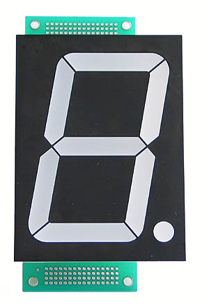

    [Paying 40 usd ] Need help with project
    This is a 7 segment display, just so you know.
