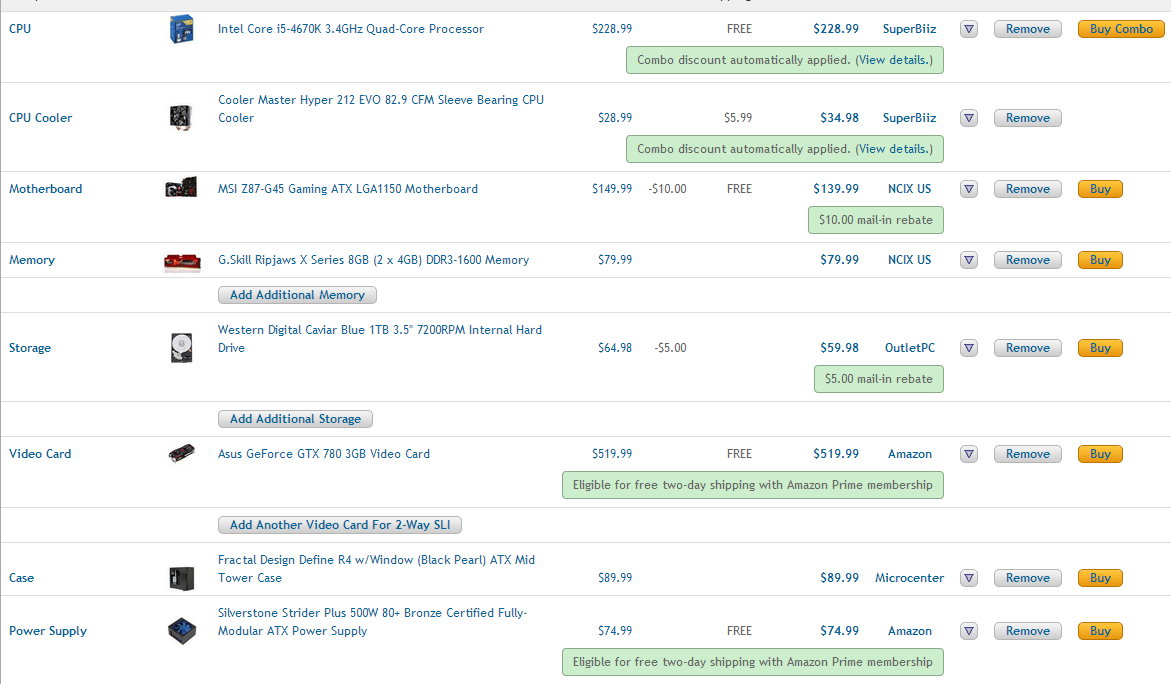

    Okay this is what i've come up with so far but i think my motherboard is stopping
    what kind of CPU i can put into computer not sure about the motherboard/CPU just want something that won't bottleneck the GTX 780.Any changes you can find would be awesome etc. :)

    You can go down to an i5-4670K. The i7 won't really help gaming performance at all. With the money saved you can buy a aftermarket heatsink which would be quieter and cooler. The motherboard is good.
    Also, you might want to change the 780 vendor. I don't think Gigabyte uses a custom PCB. Something like an ASUS 780 has a custom PCB which allows for higher overclocks, better power usage, etc.

    Thanks i wasn't even really planning on overclocking (Don't really understand how, plus so many choices when it comes to fans when you do overclock) Anything else you would change?Should i consider overclocking if i'd want to play games like farcry 3 etc?what fans would you reccomend

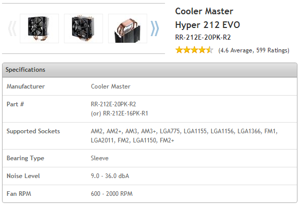

    This one?
    For the i5-4770k use this fan?

    Hyper 212's are really nice, but do tend to get kind of loud. Just a heads up. :)

    You can't stream on those speeds at all. You do have to switch out the PSU to a minimum of 600W (per GPU specs). I believe I told you that though. And again, SSD: Have you chosen one out?

    Before you buy a new PC.. you definitely need to invest in a better ISP you wont be able to stream even the lowest settings with your current Down\Up speeds.
    skateman brought up a point that i didn't even look into, the minimum running requirement for the 780 is 600w. You definitely need to get a 750w+ for some overhead.
    My EVO 212 CPU Fan is incredibly quite so i think its fine.
    If your going just for gaming the i5 4670 is more than enough and is very cost effective, if you want future proofing i'd purchase the i7 if you have the extra money to splurge.
    Besides not having an SSD and the above points, your build is perfectly fine.

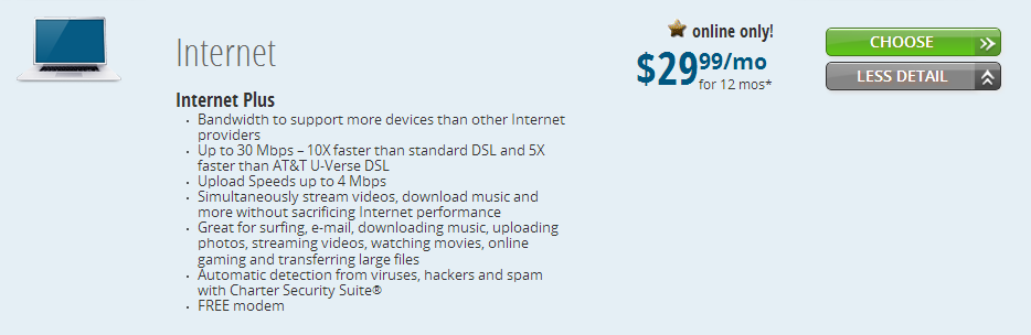

    Okay will edit my list etc, now onto my SH**ty ISP, okay i'm going to switch to charter internet would this be a good deal ( Good enough to stream+Play games etc from your experience of using charter (if you have ))
    Edit: i think the ISP im using now and charter are the only ones available in my area is there a way to find out if there are more?

    You need to find out the upload speeds for those plans.
    You need a minimum of 3Mbps to stream 720p on twitch. That 30Mbps is probably download speed which is irrelevant.
    A simple google search "ISPS provided in my area" Should help find whats being offered.
    Maybe call your ISP and see if they have higher tier speeds.

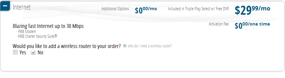

    Okay ehm this is what i can get, are my current upload / download speeds affected by what computer i'm using now? or? [​IMG]

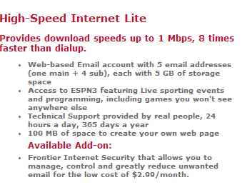

    MY Current Sh**t

    No idea honestly, twitch support forums just says 3Mbps upload speed for 720p.
    Edit: Banshee that Charter service should be sufficient.
