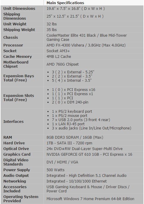

Im thinking about buying this setup, is it worth it?
http://pcpartpicker.com/ <---- or if someone would give me the parts to build computer. Id like to play games on HD. I like to multi task (render Videos, play games, watch streams @ the same time etc) can spend up to 600
All most exactly the same as mine , but ive got 16gb ram and bigger hard drive, but that is just nit picking, should run good man :)
600USD and are you planning to run any games or just normal usage?
For 600USD, for me at least, it is not worth to be honest. 600USD could get you a better specs definitely.
I agree with what everyone else says. I feel like you should be able to get something better for $600. Two RAM slots bothers me, personally. I've gone past 8GB so I really needed that extra RAM. You should also compare AMD processors to Intel processors / check the specs on that particular CPU. It may not be what you want.
Also, it is better to pick the pieces instead of buying a pre-made computer.

For $600, a gt 610 has no place for involvement in that build. You can build much better. Don't let building scare you. Its a learning process, but its pretty easy.
