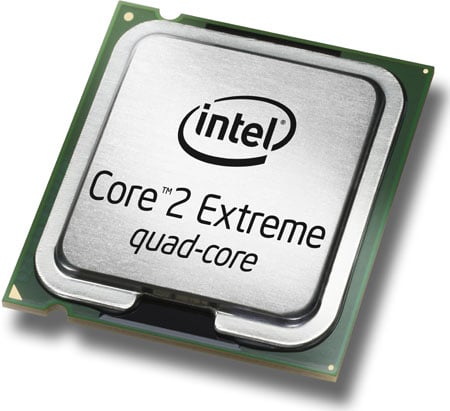

Now you need to get the CPU in. You have to be VERY careful with this, if you break the little pins at the bottom which connects it to the mobo, it's useless. In the picture circled in red, this is where you need to put the CPU, simply flip back the lever, then flip back the second protector, and place it in VERY carfully, if you don't know which way round to put it have a look at the bottom. THERE IS NO PUSHING IN NEEDED, IT WILL SLOT IN VERY EASILY.

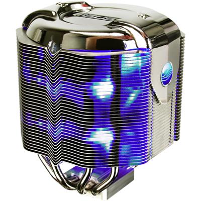

Now you need to put the Heatsink Fan above the CPU. Most of these fans come with a preapplied layer of thermal paste. If you look at the picture above of the HSF, you will see little clips, it has four of them to be exact and if you look at the motherboard pictures around the CPU, there are four holes, you simply put the clips into the holes on the mobo and turn them so it locks into place.

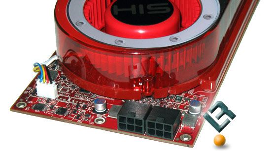

Some Graphics cards need even more power from the PSU, there will be a little plug at the back of the card, either 6 pin or 8 pin or both.

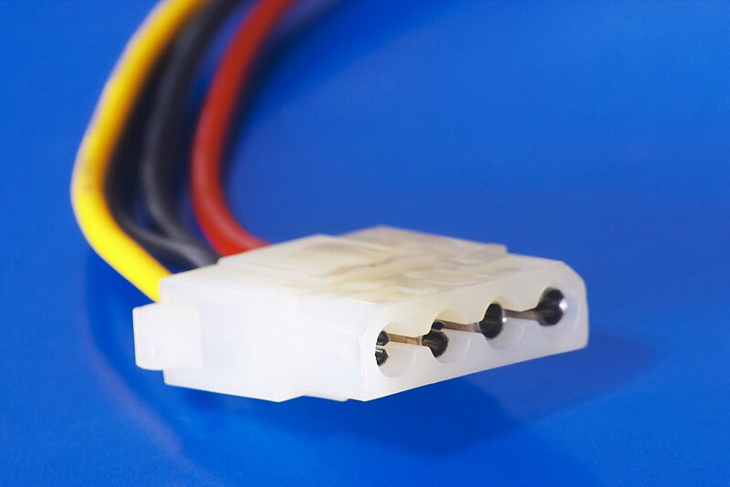

Alot of fans these days use the old IDE HDD power, they are called MOLEX connectors.
