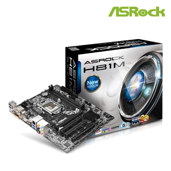

Pick Your Motherboard
Now that you know which processor socket you'll need, it's time to pick your motherboard. On a budget build, you want to keep this fairly cheap. A good motherboard is ESSENTIAL for higher end gaming builds, but on a budget build it isn't so important you can usually buy one for chips if you shop around. All that's really important is that it will support your CPU, your RAM, and your graphics card.
As with the processor, most decent hardware sites will have already separated the motherboard by brand and CPU socket type. In the case of my budget built, I used an i3 with an LGA1150 socket, so I'd pick this category:
Now if you sort motherboards by price lowest to highest, you should come up with a few good options. In my case, I chose ASRock motherboards as they're cheap and decent for what I needed, but shop around a little. The main features you'll be wanting are DDR3 RAM support, how many USB3 ports are supported, and how many PCI and PCI-E slots are available for things like graphics and wifi cards.
In my case, I chose this one for AU$65:
Just by looking at it, if you have a little experience you can see it supports 4 USB3 ports, 2 USB 2 ports, surround sound, Ethernet LAN, 2 DDR3 RAM slots, 2 PCI slots and 2 PCI-E slots. For the less experienced user, you can find this stuff in the description. PCI-E x 16 is essential for graphics cards, so make sure there is at least one of them.
A lot of motherboards offer up to 4 RAM slots, but on a budget, 2 RAM slots is more than enough.
Budget Remaining: $460 - $65 = AU$395
