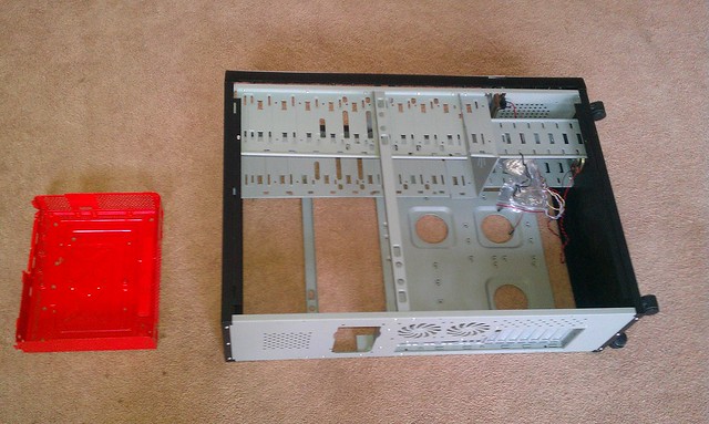

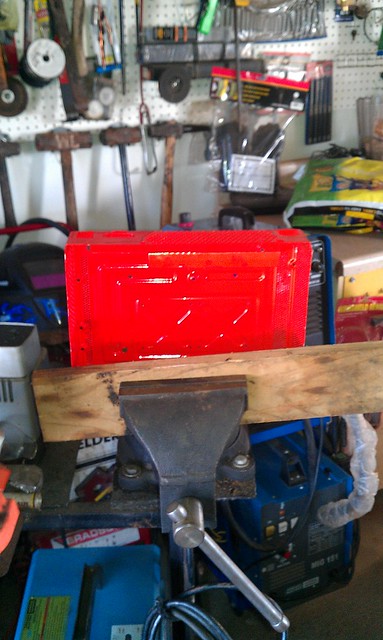

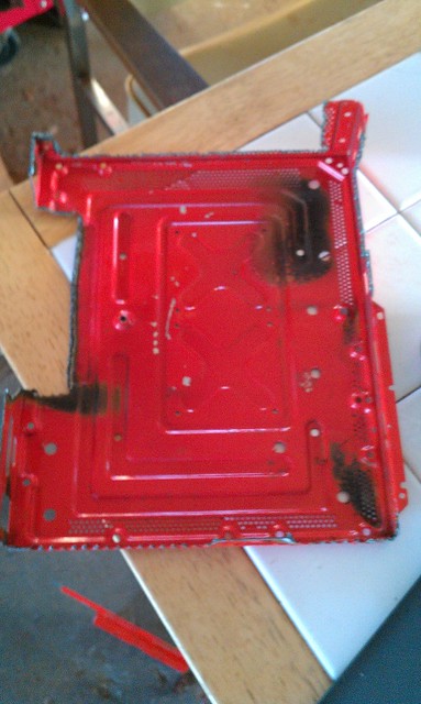

    Time to trim off the sides to make the Xbox mobo more presentable!
    After the plasma cutter got a hold of it (still rough edges).
    After cutting out some of the drive slots to make room for the Xbox it is time to PAINTT (It is even lol lots of shadow)!

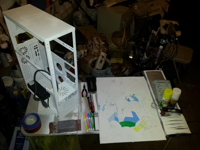

    Layer 1
    1.25.12 Outlined+Began coloring some of the fluorescent areas.
    The outlines will be done in a darker black to stand out then covered in a clear coat.

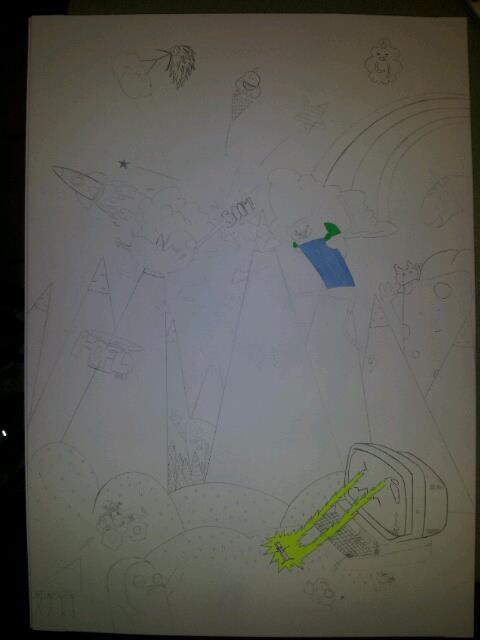

    1/26/11-A lot done today!
    Well it might not look like it but a ton was finished up today. The pc face plate was sanded and ready for the last layer of white. I got the xbox components up and running and now I am just waiting on a dry day to paint. Drew a lot more on and colored a few things. I also have decided it would be easier and more efficient to run the original xbox power supply and not wire it to my PSU. I will be painting the power supply brick white and sleeving the cable UV white. It will also be pinned up the corner of the box so it is not messy. Good day.

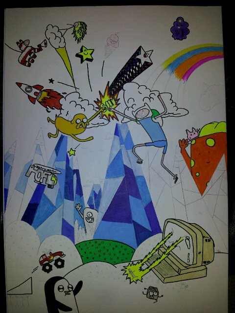

    FINISHED SIDE
    Added so much to it wanting to get as many characters as we could! we also added the infamous snail that is hidden in every episode! HAHA it came out amazing! Shout out to my friend for the artistic ability he has!
    Finished my painting 2/15/12

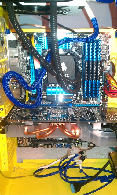

    As of now the fans are in and I have started sleeving all of the cables. I bought a 140mm intake fan 2 80mm exhaust and a 120mm fan will be exhaust at the top. I also bought a professional sleeving kit along with a CP cooler and a cooling system for the xbox from Xoxide.com. I will update once the cables are sleeved.
    The xbox IS VERY PICKY when it comes to cooling. So make sure if you try this you have a large amount of air flowing over the heat sinks! Even outside of the case I had to have a larger fan on it to keep from overheating.

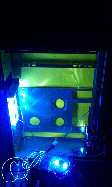

    Testing out my LEDs! 2-24
    GOT THE PARTS TIME TO INSTALL EVERYTHING! 2-24
    Sorry everyone for the delay. I have had some work issues to deal with and it was completely draining and annoying. I changed up the parts I got and will update the top section with them. I also sleeved the majority of cables inside blue to so I think it will look amazing!
    All of the PC parts installed! 3/1/12
    Everything is installed and started up the first try. Overclocked the CPU to 4.5GHz and is stable. It also looks beautiful!

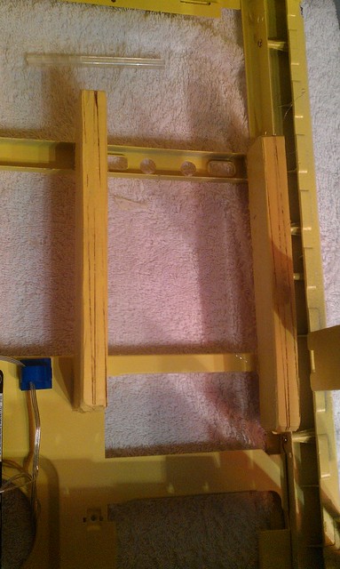

    Stilts
    I used some glued together shems to create stilts for the xbox to sit on so that it is above the PC components. It also creates more surface area for the glue to hold on to.
    Xbox Mounted
    I have the xbox mounted on the stilts with a piece of electrical tape in between them. I ran it all night to ensure that long duration gaming will not heat up and damage the bond with the glues.

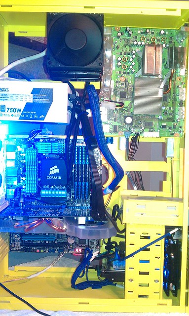

    COMPLETED ALL HARDWARE
    YAY! Now it is time to make wires and everything look neat and add touch ups! Everything runs great even pulls a 7.8 WEI with only the CPU getting a 7.8! There still are a few Miscellaneous things I will update but for hardware, it is done!
